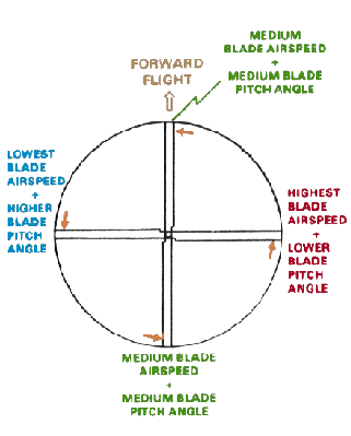

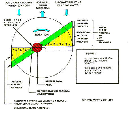

    Dissymmetry of lift is caused by the fact that rotor blades moving in the same direction as the helicopter are moving faster through the air and thus generate more lift than the blades on the other side of the disk which are moving with the air and thus generating less lift. More lift means a steeper coning angle. From the outside it looks like the cone is leaning away from the side of the rotor disk that is headed in the helicopter's direction.

具体解释参见:
http://www.dynamicflight.com/aerodynamics/dissymmetry/
http://www.simhq.com/_air13/air_427a.html

回复 7# leier3525165
    如果飞机向前300公里每小时 那旋翼往前转到和航向垂直的时候旋翼速度就是600 那另一边回来的旋翼速度就是0 旋翼速度600时的升力大于速度0时的升力 升力大弯曲就厉害
